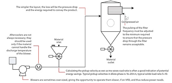

Dilute-phase conveying, in which solids are suspended in the transport air (Figure 1), is very common because it is quite simple to design and operate. The air mover generally is a Roots-type blower that can be positioned either at the beginning of the line (pressure dilute phase) or at the end of the line (vacuum dilute phase).
Dilute-Phase Pneumatic Transport
Figure 1. A number of ways to save energy usually are possible in such systems.
Experience shows that plant operators place most importance on avoiding line blockages and achieving a defined throughput. They, therefore, are tempted to select an over-sized blower and run it at high speed, which appears to them as being safer (but, in reality, is not quite true). Those blowers have motors drawing several kW.
An engineer looking for energy savings should calculate the air velocity in the conveying pipe and the solids loading ratio. Typically, a dilute-phase conveying line has a speed of 20–30 m/s at the end of the line and a solids loading ratio of around 5–10:1. If the values calculated for the line significantly differ, with a higher conveying speed and a lower solids loading ratio, then reducing the blower speed possibly may save energy. Organize a trial (always perform a risk analysis first) with the help of a pneumatic conveying expert to find the optimum conveying parameters.

Design
Even better environmental and economic results can come from considering energy savings at the design stage. Keep the following pointers in mind:
• Design a simple layout for the pneumatic conveying line; additional length and bends cause extra pressure drop and, therefore, require more energy.
• Determine experimentally the minimum conveying velocity of the material to be transported. As shown, a velocity higher than required will lead to substantial energy overspending.
• Control the design margins used by vendors; for instance, blowers sometimes are over-sized.
• Do not automatically position an aftercooler after a blower in pressure dilute-phase conveying; you may not need such a unit. Only install an aftercooler if it is proven that the system or the product cannot stand the temperature increase due to the blower compression.
• For dense-phase operation, carry out experimental trials to design the line so it can convey at the highest possible solids load ratio.
• Design the automation system to keep a line from running without product. Use a timer to switch off the line after a certain time not handling material.
• When possible, take advantage of gravity to move powders and, so, reduce the use of pneumatic (or mechanical) conveying.
• Ensure, when possible, treated air is not lost but recycled.
