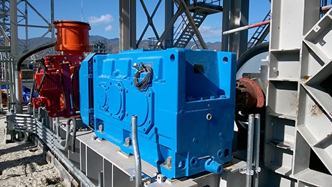

Drive Unit
Figure 1. A high-speed belt conveyor typically relies on an electric motor, gear box and coupling.
