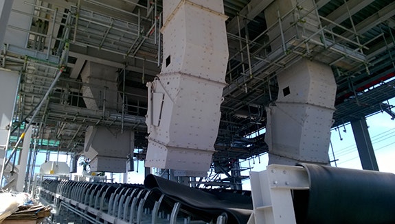

Chutes should be strong and rigid to resist massive forces and potential erosion and corrosion (Figure 1). For commonly used applications, chutes usually are constructed from steel plates of 8-, 10-, 12- or 16-mm thickness or more. Specifically, small and medium chutes (bunkers, hoppers, etc.) generally use 8-, 10- or 12-mm plates. Large chutes (or silos) might need thicker plates, sometimes even 16- or 20-mm ones, depending on load calculations and modelling.
Ease of maintenance is a key consideration. Chutes often are constructed in flanged sections connected with bolting. The number and sizes of bolts are important. As an indication, common chutes use M16 or M20 bolts. Sections requiring removal for maintenance most often are fitted with lifting eyes or lugs located in convenient positions. Frames, flanges, supporting structures or head integral with plate fabricated items should be made from thick plates or properly selected profiles; such flanges typically are fabricated from 16- or 20-mm (or even thicker) plates.
A chute usually comes with a large hinged inspection door — generally at least 600 mm × 600 mm — to enable the clean-out of blockages and to ease inspection and maintenance; necessary maintenance tools may mandate even larger dimensions. The inspection door should be dust tight as well as easily opened and closed without the use of tools.
