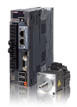

Mitsubishi Electric Automation, Inc. introduces the MR-J4-TM multi-network servo drives with EtherNet/IP and EtherCAT interfaces. A Profinet interface will be available later this year, according to the company.
The Advanced Vibration Suppression Control II, One-Touch Auto-Tuning, 2.5kHz speed frequency response and 4,194,304 pulse per revolution encoder resolution reportedly make it easy to integrate into new and existing machine designs.
The MR-J4-TM also includes standard IEC61158 Type12 CAN application protocol over EtherCAT (CoE), IEC61800-7 CiA402 drive profile. It also comes with add-on instructions for EtherNet/IP networks using ControlLogix or CompactLogix controllers.
