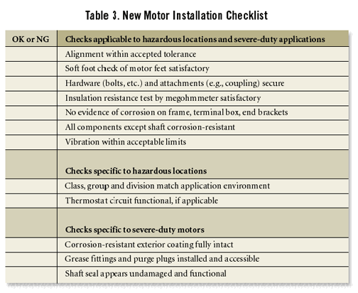

Internal temperature protection (thermostat) is required for every rebuilt hazardous location motor. No modifications are permitted that could change the motor's temperature rise or ability to contain an internal explosion. UL does allow a voltage change as long as the original winding data are available.

Maintenance of hazardous location motors is essentially the same as for totally enclosed fan-cooled (TEFC) motors. Normally, maintenance includes lubrication at prescribed intervals; inspection for damage or evidence of corrosion, dirt and other debris accumulation on the frame and fan cover; and a check of vibration levels. If the motor is equipped with a thermostat, the thermostat circuit integrity also should be checked periodically.

Tables 3 and 4 provide checklists of key items applicable to hazardous location and severe duty motors.
