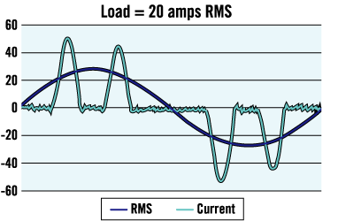

When an electrician put away the traditional average response ammeter and traced the problem with a True-RMS (root-mean-square) meter, the investigation began to get somewhere. Initial measurements of phase currents showed values that did not exceed equipment ratings. The neutral conductor was carrying nearly the same amperages as the phase currents, and the phase loads were well balanced.
At this point, attention turned to the recent installation of a medium-voltage variable-frequency drive (VFD) and, as a result, harmonic currents became the "suspects" in this mysterious scenario. Before delving deeper into this situation, however, some background on harmonic currents is in order.

Diodes located in the incoming power side of VFDs convert three-phase alternating current to direct current. The direct current then is switched by insulated gate bipolar transistors (IGBTs) to create a simulated alternating current.
Because VFDs draw current differently than non-solid-state (electronic) equipment, impedance plays a large role in this drama. Impedance is the total opposition to the flow of alternating current. It is the combined opposition of resistance, inductive reactance and capacitive reactance. Impedance is measured in ohms and is expressed by the symbol "Z." It can be shown in complex notation as Z = R +iX, where R is the ohmic resistance and X is the reactance.1
Prior to the introduction of VFDs, non-solid-state applications had a constant impedance drawing current in proportion to the sinusoidal voltage. Electronic equipment such as VFDs changes impedance by switching on and off near the peak of the voltage waveform. The frequencies are modulated to control the motor speed. Switching loads on and off causes quick nonsinusoidal current pulses.
Harmonics are the reflective currents sent back into the power distribution system by switching loads on and off during part of the waveform. Harmonics are described as sinusoidal waveforms operating at frequencies that are multiples of 60 hertz. They are expressed in orders. For example,

. Ensure the electrician uses a True-RMS meter. Average response ammeters are insufficient because they are accurate only when measuring 60-hertz loads that have sinusoidal current waveforms. They cannot measure the current of nonlinear load accurately.
Nonlinear loads draw current in a nonsinusoidal manner and produce reflective harmonic currents that operate above 60 hertz. If an average response ammeter is used to measure nonlinear load currents, readings below the actual True-RMS current might result. The actual current might exceed equipment ratings.

In the Texas plant's "Twilight Zone" case, the engineers discovered a shared-neutral wire configuration within the VFD and surrounding conductors in the control unit that were responsible for the overloads and failures. The neutral wire could not accommodate the increased amperages. These amperages were created by harmonic currents fed by the multiple hot circuits converging on a single neutral wire.
The engineers not only installed an upgraded neutral wire to accommodate these higher amperages, but also added neutral wires for the individual hot circuits. At the same time, they located several low-voltage VFDs without any harmonic filters. They installed harmonic filters and line reactors to filter the incoming voltages on the VFDs. An upgraded neutral wire now accommodates these higher amps.
