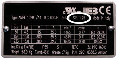

Motor Nameplate
Figure 1. The service factor of 1.25 means the motor can temporarily exceed its rated power by up to 25%.

The relative power consumption also is higher when the optimal range is exceeded. Permissible operation can extend beyond 100% of rated power if the SF is over 1.0. According to the U.S.’s National Electrical Manufacturers Association (NEMA) standard “Motors and Generators” (NEMA MG1-2016), the SF given on the nameplate specifies the degree to which a motor can be loaded beyond its rated power. The rated power multiplied by the SF value represents the degree of overloading allowed. For the nameplate shown in Figure 1, the SF of 1.25 means the real maximum rated power is 25% higher than indicated. So, in the case of this 15.0-kW-rated-power motor, the maximum permissible, thus real, rated power is 15.0× 1.25 = 18.75 kW.
