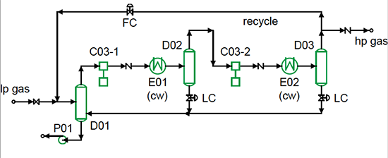

Figure 1 shows a schematic of a two-stage reciprocating compressor system. Each stage has both a suction knockout drum to protect the compressor from liquid in the feed and an aftercooler to reduce the process temperature. The first-stage aftercooler helps prevent excessive temperature into the second stage suction. While operating, the compressor system uses both a flow control recycle line plus suction valve unloaders on the compressor stages to control compressor capacity.
Two common ways of starting up reciprocating compressors at no load use the normal-operation capacity controls to decrease the starting load to zero. These methods are total recycle through the recycle line, and running at zero load with the inlet valve unloaders open.
Operating with the recycle flow valve in Figure 1 fully open reduces the discharge pressure to the suction pressure, minimizing the torque at startup. (Each stage may have its own individual startup line rather than the common line shown.)
Using the recycle line to decrease load means the entire flow is cooled through the after-coolers. Compressor suction temperatures stay within normal operating ranges. This configuration requires the product check (no-return) valve to seal well. If that valve doesn’t seal, reverse flow from the discharge can enter the system.
Two-Stage System
Figure 1. The recycle line in this reciprocating compressor setup provides a means for no-load startup.
lp = low pressure; hp = high pressure; cw = cooling water
The flow control valve then is closed until discharge pressure rises enough to force flow forward. Net capacity can be smoothly increased to prevent excessive torque changes on the machine and motor.
