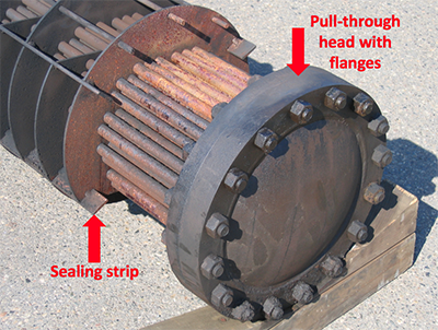

Many heavier-duty exchangers use an S-type or T-type rear head. These head types handle straight tubes and feature an internal chamber with a flange to accommodate the return of the tube-side flow. In these exchangers, you can remove the entire bundle from the shell by pulling it out through the shell. Therefore, the return head must fit inside the bundle.
Figure 1 shows a T-style return head. The head’s flange with its bolting circle must fit through the exchanger shell. The flange prevents installation of tubes around the outer edge of the bundle. The smaller the tube bundle is, the larger the tube-count reduction that’s caused by the flange. The higher the pressure of the tube side is, the larger the flange and, so, too, the tube-count reduction. The exchanger shown in Figure 1 has a relatively small bundle with a moderate tube-side pressure rating. The tube-count reduction (and lost area) is relatively large.
T-Style Return Head
Figure 1. The necessary flange limits the number of tubes in a bundle.
Additionally, the distance between the tube and the shell opens up a larger area where shell-side liquid can bypass the tube bundle. Bypassed flow reduces heat-transfer effectiveness. Using sealing strips as shown in Figure 1 reduces the flow bypass but doesn’t eliminate it.
