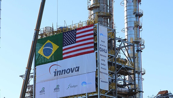

The Direct Heating Unit
Having identified solutions for the catalyst and hydraulic limitations of the system, the engineering team then turned to finding the best way to supply high temperature heat to the system. In the three-reactor configuration, the combined ethylbenzene feed/reactor effluent stream to the new third reactor required heating to 630°C from roughly 550°C.
During the study phase of the project, the team considered conventional methods for supplying this high temperature heat; these included adding a third superheater, extending the fire box of existing heaters, and increasing the amount of feed preheating. However, in due course, the team determined that the Direct Heating option was most economical.
The Direct Heating technology resulted from years of cooperative research and development by Badger, TOTAL Petrochemical and Refining, and Shell Oil. In general, the technology takes advantage of a concept initially proposed by Shell Oil for crude oil recovery from subterranean rock formations. The Direct Heating Unit (DHU) employs the novel concept of flameless combustion — achieved by separately preheating air and fuel gas such that the mixture temperature exceeds the fuel’s autoignition temperature. Unlike conventional furnace burners that combine large amounts of fuel and air at a single point, the DHU works by adding fuel in small increments into a high velocity air stream via injections over an extended heating zone. By combining air and fuel in this way, the fuel reacts more slowly in a controlled manner and at significantly lower temperatures than in classic combustion, which gives off concentrated visible light (i.e., a flame). One advantage of using this technique in the styrene process is that the dehydrogenation reaction generates hydrogen; its relatively low autoignition temperature makes hydrogen an ideal fuel for flameless combustion.
As with most revamp projects, the team carefully considered the location of new equipment. The proposed fired superheater had to comply with both industry risk mitigation practices and insurance obligations that require fired devices to maintain minimum spacing requirements from nearby equipment containing flammable materials. At the Triunfo site, the available plot space for a new fired heater was relatively remote from the reaction section. All practical locations would call for more than 100 m of large-bore high-alloy steam piping that typically operates at over 800°C as well as numerous expensive expansion joints. From an operational standpoint, a distantly located fired heater would result in high piping heat losses and an undesirably high steam-system pressure drop.
Compelling Advantages
Conceptually, the DHU shares many characteristics of a conventional heat exchanger. However, the unit boasts a significantly smaller footprint than a fired heater (about 25% less), and doesn’t incur the above-mentioned placement constraints. So, it could be located conveniently near the existing structure. Moreover, the all-important process-side pressure drop is far lower than that of the standard reheat exchanger approach. From a safety and design simplicity standpoint, Innova particularly appreciated that the DHU design eliminated the complicated burner management system, large fire box, pilots and complex safety interlocks associated with a fired heater. In addition, because the DHU combines two unit operations (fired heater/exchanger) into a single vessel, it offers a lower total capital cost.
Based on these advantages, Innova chose to apply the novel DHU technology for its plant expansion. Following basic design, detailed engineering and commissioning, the revamped unit successfully went onstream in May 2019.
