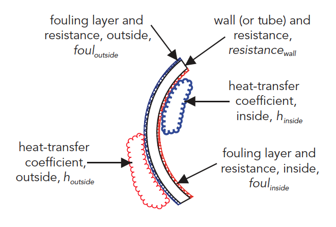

The overall heat-transfer rate (Uoverall) achieved in a heat exchanger depends upon the overall resistance to heat transfer, which is its reciprocal (1/Uoverall). This, for a unit with a wall between two streams, is the sum of five factors:
1/Uoverall = 1/houtside + foulout + resistancewall + 1/hinside + foulin (1)
where 1/h is the film resistance for each surface, and the other factors are the resistance of the wall or tube, and the fouling resistance at each surface. Figure 1 shows these factors for a tube in a shell-and-tube heat exchanger. Many users have some sense of the fouling factor likely for most of their heat exchangers.

Simplifying Eq. 1 by taking the wall resistance as zero and combining the inside and outside fouling, we get:
Fouling = 1/Uoverall - 1/houtside - 1/hinside (2)
Heat Transfer Resistance
Figure 1. Tube in a shell-and-tube exchanger illustrates the five factors that contribute to the overall resistance.
The resultant value comes from subtracting two relatively large numbers from another large number. This concept poses potential problems, as I’ve discussed previously (see February 2015 issue’s “Resist the Temptation”). When using plant data to determine the fouling factor, all errors in the calculation accumulate in the final result.
