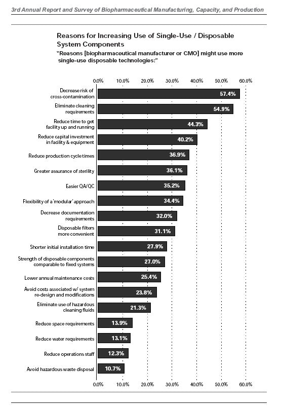

In addition to speed, cost, and reduction in cleaning requirements, manufacturers also chose disposables to decrease the risk of cross-contamination and enhance sterility and quality assurance (see chart).
Reasons for increasing use of single-use system components (click image to enlarge)
