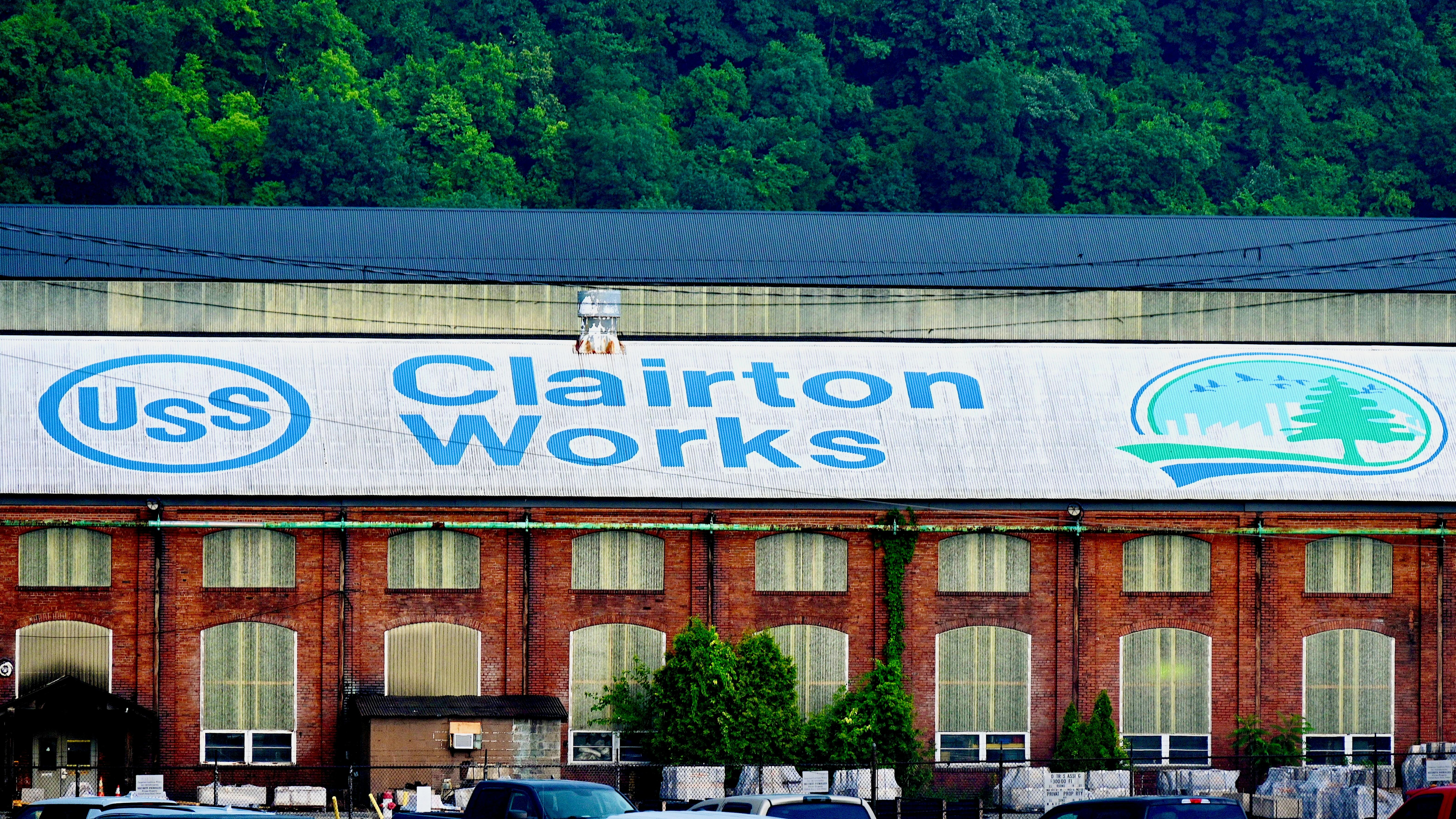

Preliminary information indicates the explosion occurred during maintenance of a gas isolation valve in the basement of the Battery 13/14 transfer area. U.S. Steel employees, assisted by personnel from MPW Industrial Services, reportedly attempted to flush the valve seat with water when gas monitors alarmed. Less than one minute after evacuation orders were given, an explosion occurred, the agency said. The explosion caused extensive structural damage and delayed recovery of one of the fatally injured employees for approximately nine hours.
According to the CSB’s investigation, the valve involved was an 18-inch, double disc gate valve made of cast iron in 1953 and refurbished in 2013. Post-incident examination revealed a circumferential split in the valve body, and additional valves recovered from the site showed signs of damage.
