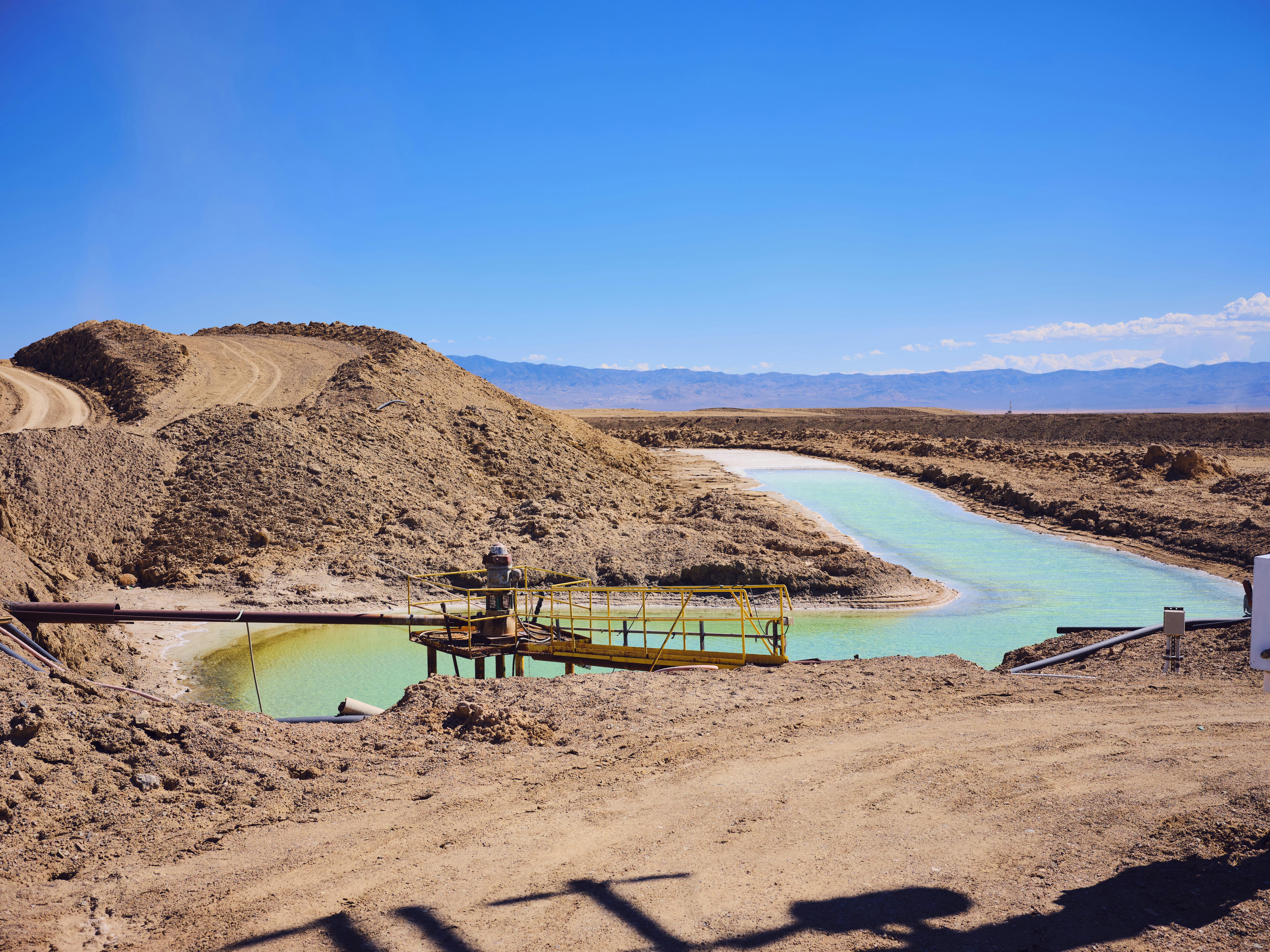

Existing lithium-extraction processes typically involve time-intensive solar evaporation and expensive precipitation and filtration steps. DLE filters lithium from multi-ingredient liquid streams. Companies like Exxon Mobil have announced plans to use the DLE process for lithium-extraction activities because it’s considered to be more energy efficient and environmentally sustainable.

For instance, South America is home the "lithium triangle" where vast deposits of the mineral exist.
SQM, Albemarle and Arcadium Lithium are among the leaders extracting lithium brine from the region along with DLE technology providers, such as Adionics, Summit Nanotech and CleanTech Lithium.
But applying DLE in countries like Chile, Argentina and Bolivia is difficult due to the high altitude. Many areas in these regions lack infrastructure for transporting large equipment and materials, according to IDTechEx.
