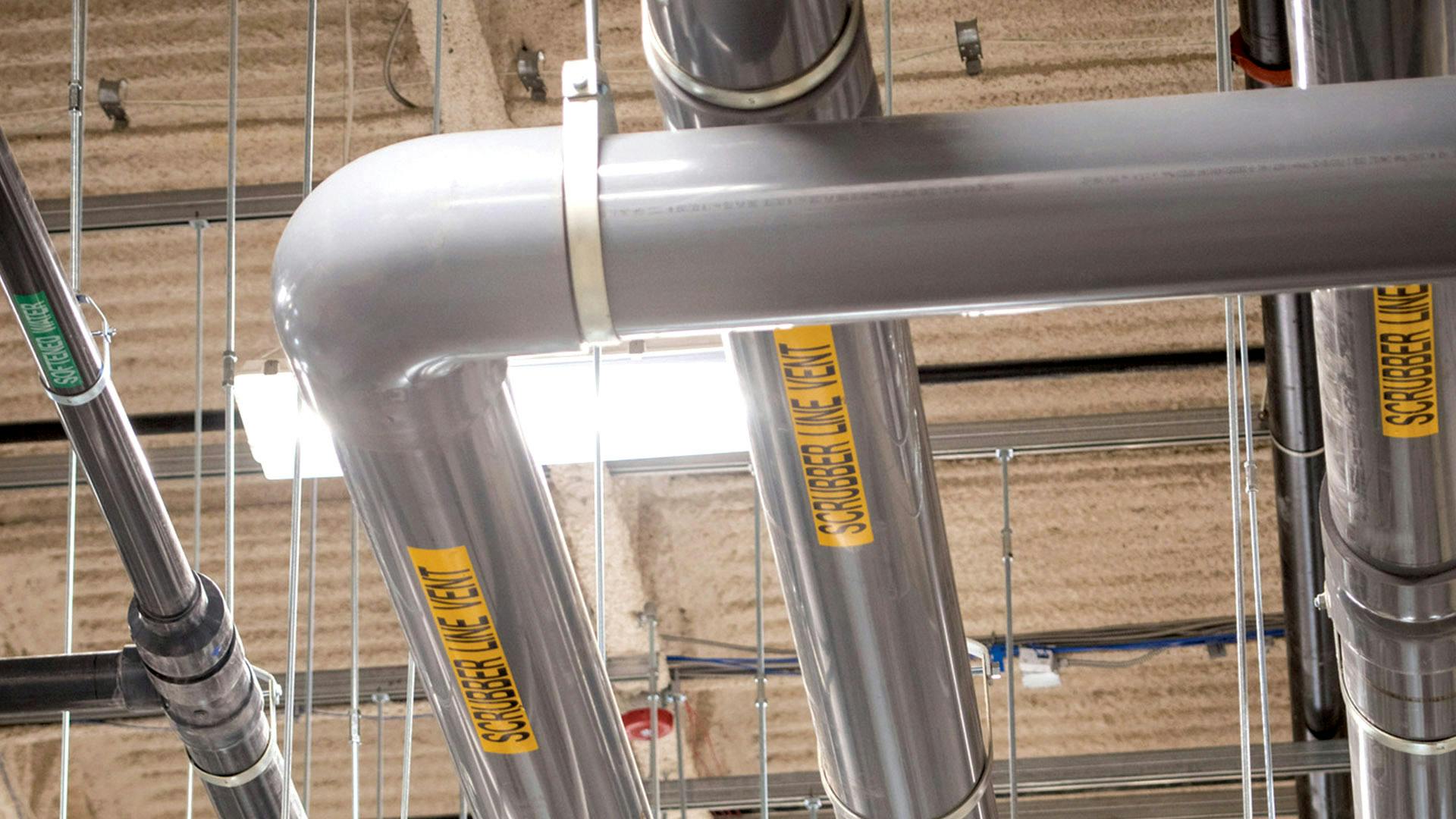

A: There’s an “inside” and an “outside” answer. One of the most overlooked things when selecting a piping material is a comprehensive understanding of all the media that will come into contact with the system. It makes sense to choose a material based on the primary process fluid, slurry or gas that will run through it and sometimes easy to overlook the secondary chemicals, cleaning compounds, or byproducts in the system. Even trace concentrations of certain chemicals can degrade materials over time, can compromise system integrity or can contaminate the overall product quality. A thorough chemical compatibility assessment of everything that might run through a piping material is critical to long-term performance.
Corrosive external conditions can also be overlooked and underestimated and end up shortening a piping system’s service life. For example, coastal environments are often very humid and saline, both of which can significantly contribute to corrosion. Prolonged exposure to ultraviolet light or chemical vapors, such as the acidic mist in a galvanizing plant, can speed up piping material degradation–not to mention the toll from extreme outdoor temperatures and radiant heat from nearby equipment or structures or the expansion and contraction of freezing and thawing. It’s very important to understand both what’s going through the pipe and the external environment in which the pipe will be operating to make sure it can perform reliably under both internal and external stress. This can help reduce unplanned maintenance and downtime and keep the system operational for longer.

A: I’d give three pieces of advice. The first is related to what I said before, about not focusing only on initial cost. Looking at just the price tag could miss some heavy expenses that come right after purchase, during construction or during maintenance. Where pipes end up in a facility may make it difficult or impossible to do hot work (versus a material that could be solvent-welded). The same is true for weight and ease/difficulty of installation in general: final pipe placement may be in tight spaces that could necessitate operation shutdowns if the piping material is heavy enough to require special lifting equipment.
Second is to view systems holistically, rather than as individual parts. Thinking about medium, temperature and pressure throughout the whole system, and not just one element of it, lets you really calculate whether a material is overkill or if a single-material system maybe is the right choice for a long-life, cost-effective system.

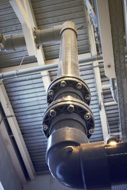

A: Material selection plays a very important role, but it’s just one factor. It all comes back around to that point about holistic thinking. This includes ensuring chemical compatibility between the pipe material and the medium that will run through it. It also includes insisting on quality from start to finish.
Use proper joining techniques. Whether you’re using solvent cement, mechanical couplings, welding or brazing, all joining methods need properly trained workers to perform the work. Poor installation will always create the weakest, most maintenance-prone parts of any system. In a similar vein, purchasing high-quality materials rather than choosing a cheaper option can get you those intangibles like traceability, excellent product support and confidence that you can really trust that the material can keep its promises. Nothing can ever eliminate risk, but material selection choices can help minimize risks.
