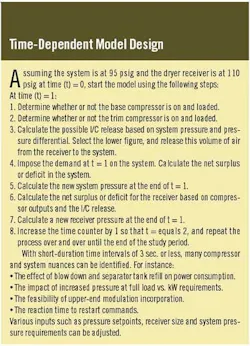

Computer modeling requires a series of tradeoffs among accuracy, complexity and desired results. Microsoft Excel or other commercially available spreadsheet software can be used to program a computer model that can be executed quickly.
The key questions in designing a time-dependent model are:
What characteristics or results are to be identified by the model?
What time interval is required to accurately illuminate these characteristics?
What and how much data are required?
What constraints related to data processing or data storage are present?
Each of the questions involves a decision about what time interval (Dt ) the model should use. Selection of a time interval depends on the individual system and how the results will be interpreted.

An Excel spreadsheet and the modeling steps previously described can be used construct a detailed model of a compressed air system. System parameters can be manipulated easily and the results computed within seconds. The demand profile also can be adjusted to reflect a leak reduction program or the addition of moisture load/purge controls for the air dryer.
