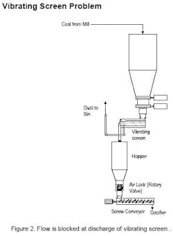

A vibrating screen separates pulverized lumps of coal from dust. The screen is fed from a lock-hopper above. The fine particles must be separated because they could become carry-over for a gasifier (entrained-flow); a pelletizer scheme is being tested to re-use this material. The lumps are then fed to a screw conveyor to the gasifier. On a vibrating screen, solid is supposed to be spread evenly across a mesh screen (Figure 2). The rocking motion and the slight slope cause the solid to flow towards the discharge and into either the pneumatic conveyor pick-up pipe or the hopper for the screw conveyor. This isn’t happening. Instead, coal is building up on the screen and blocking flow from the lock-hopper above. The screw conveyor hopper is plugged and the pick-up pipe is plugged. Adjustments to the slope and the rocking motion have been increased to no avail. Any suggestions?
Send us your comments, suggestions or solutions for this question by August 11, 2006. We’ll include as many of them as possible in the September 2006 issue and all on CP.com. Send visuals — a sketch is fine. E-mail us at [email protected] or mail to ProcessPuzzler, Chemical Processing, 555 W. Pierce Rd., Suite 301, Itasca, IL 60143. Fax: (630) 467-1120. Please include your name, title, location and company affiliation in the response.
