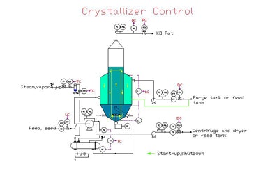

Crystallizer Control
Figure 1. Poor temperature control can lead to small crystals instead of the desired larger ones.JULY'S PUZZLER We recover ammonium sulfate from a power plant scrubber and sell it as fertilizer. Temperature control of the liquor going to the crystallizer is critical; liquor is circulated through a shell-and-tube heater (see Figure 1). Poor control causes nucleation, creating small crystals at the expense of large ones. The difference between the inlet and outlet stream temperatures must be ±1°F. Our customer originally insisted on using a controller temperature board in its central control room, which is more than 300 yards away, but now is demanding that we use K thermocouples. Will either idea work? What's the best way to get the accuracy needed? Send us your comments, suggestions or solutions for this question by June 11, 2010. We'll include as many of them as possible in the July 2010 issue and all on CP.com. Send visuals — a sketch is fine. E-mail us at [email protected] or mail to Process Puzzler, Chemical Processing, 555 W. Pierce Road, Suite 301, Itasca, IL 60143. Fax: (630) 467-1120. Please include your name, title, location and company affiliation in the response. And, of course, if you have a process problem you'd like to pose to our readers, send it along and we'll be pleased to consider it for publication.Sponsored
