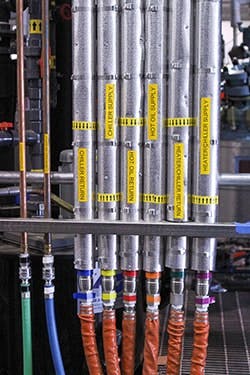

Grouped Process Connections
Figure 1. Such an arrangement simplifies initial hookups and, if required, later moving the skid to another location.
