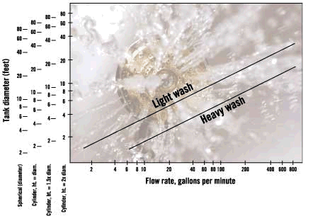

Figure 2. Tank-Washing Nozzle Selection
This chart can assist in the selection of a tank-washing nozzle by calculating the flow rate required based on interior surface area.
Flow rate
What is the operational flow of the unit, and how is it distributed? "How much liquid does it take to wash my tank?" is a common process-specific question, but guidelines do exist.
One of the most common rules of thumb is 2.5 gpm to 4.0 gpm per foot of linear circumference for vertical cylindrical tanks with a height of less than four times the diameter. Another is 0.25 gpm to 0.40 gpm per square foot of interior surface for square tanks or those with more complex shapes. Sometimes the values go even higher.
These guidelines originated around the process of tank washing with stationary spray balls and assume all surfaces are being sprayed at the same time. The testing suggested this process is not efficient.
Instead, the tests indicated that the sweeping action of a rotating nozzle increases the cleaning efficiency substantially. For an appropriately sized unit in which the soil is not highly aggressive, it would be better to use a guideline closer to 1.0 gpm per foot of circumference. For other tank configurations, a guide of 0.1 gpm per square foot of interior also will work.
These numbers might be too low if the cleaning action is particularly difficult. The ultimate selection is something you will have to base on testing and experience.
