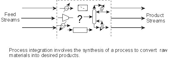

Many of the people who are aware of Process Integration equate it with the design of heat exchanger networks.  This is a popular misconception.  Although the design of heat exchanger networks is part of Process Integration, the discipline is far wider.  Process Integration has the objective of the design and optimization of integrated chemical manufacturing systems.  Process Integration starts with the selection of a series of processing steps and there interconnection to form a manufacturing system to transform raw materials into desired products (see Figure).
