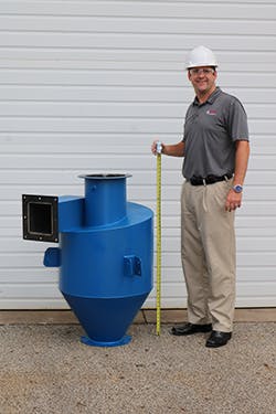

Aerodyne Environmental, a manufacturer of industrial dust collectors and material handling valves, introduces the Dust Hound Dust Collector. About 55% as tall as a standard cyclone for the same efficiency and airflow, it more easily fits available space without costly facility and process line renovations. It is up to 99% efficient at 20 microns.
Small cyclones can be used for point-of-use dust collection that may help managers achieve NFPA compliance for potentially combustible dust without costly ductwork. Per NFPA-654 7.13.1.1.2 (2), air separators with a dirty side volume less than 8’3” can be safety located indoors, under certain circumstances. Constructed of carbon steel, the Dust Hound cyclone uses a specially shaped ground plate to divert dust towards the walls and to interrupt the airflow, creating a very localized pressure drop that causes more particulate to fall out of the airstream and reduce dust re-entrainment.
