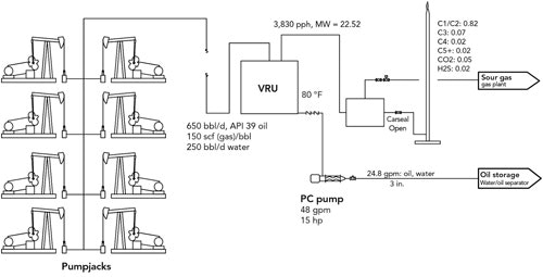

The pipeline company I work for replaced some centrifugal pumps (CPs) that performed well for over 20 years with progressive cavity (PC) pumps at an old oilfield gathering station (Figure 1). After two months’ operation, the PC pumps suddenly failed. Because the station is down, the company decided to do some much needed maintenance. While sniffing for leaks before construction could begin, we discovered several, in particular around the new pumps. In addition, it looks like regulators will ding us for over-using our flare and for complaints about hydrogen sulfide emissions because the flare failed to ignite properly.
My first problem is finding out why the PC pumps failed and what to do about the flare. We had relied on a world-renowned engineering company for the previous work; it had highly recommended a particular make of PC pumps. However, my company opted for a different pump vendor because maintenance insisted on the brand for “consistency” in the equipment inventory. The engineering company also installed a new flare ignition system about the time of the pump replacement.
Why do you think the CPs ran so well for so long and the PC pumps failed? Is the flare problem somehow connected with the pump failure? What other thoughts do you have?
Oil Gathering Station
Figure 1. Problems arose soon after centrifugal pumps were replaced with progressive cavity units.
