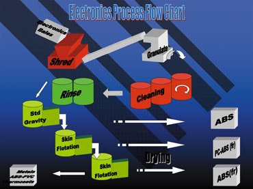

In the computer-scrap process, baled waste first goes to a shredder and then a grinder. Next, the ground material is washed and rinsed. Standard gravity separation follows, producing an ABS product stream that also contains up to 10% polystyrene.
Making flotation work
The densities of flame-retardant ABS and PC/ABS overlap, so conventional flotation cannot be used to separate them. However, RPI realized that the flame retardants used for the two plastics differ in how they affect the materials’ hydrophobicity. The phosphates used as flame retardants for PC/ABS hinder wetting and encourage the attachment of air bubbles to the plastic’s surface. The brominated compounds used for ABS have the opposite effect.
Recovery of plastics from computer scrap takes advantage of the differences in hydrophobicity of flame retardants to separate materials by skin flotation.
RPI’s so-called skin flotation relies on the attachment of air bubbles to produce separation. It employs two flotation circuits in series, adding different plasticizers to each. The first recovers flame-retardant PC/ABS, and the second yields flame-retardant ABS. The PC/ABS contains less than 3% ABS, and the flame-retardant ABS includes 5-10% PC/ABS. Residue, which includes metals and other plastics, is placed in a landfill.
