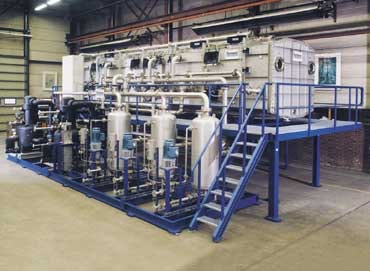

    From supersize to modular
    The largest pressure filters built to date, each roughly 28 m2 in area, have been installed at a monomer plant in the Far East. Each filter has a housing design pressure of 225 psig and design temperature of 250°C, with operating conditions around 150 psig and 200C. The filters carry out filtration and cake washing at elevated pressure, enabling removal of impurities that would remain in the filtrate if washing occurred at atmospheric pressure.
    On the other extreme, the HVBF filter lends itself to compact modular designs and packaging, especially since gas-tight and pressure-tight systems are installed as closed loops. Filtrate receivers, pumps and vacuum pumps can be packaged on one skid, combined with the filter and support structures and access platforms.
