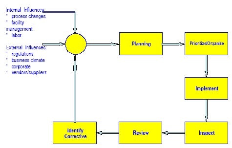

  • Having worked on EMS-related issues for quite some time, I have seen a number of issues related to management system shortfalls. I also have seen companies that were committed to continually improve their EMSs. They were truly committed to seeking areas for savings in resources and manpower, while striving to minimize waste streams, and fully empower their employees to make the important day-to-day decisions.  Satisfying the registrar was more of an “attaboy” than the primary goal. Like Demming’s quality management method, ISO-14001 is a continuous improvement plan (Figure 1). These companies understand that having an EMS at peak performance will take care of itself, and everything else will fall in line. That is the true intent of ISO 14001, not the sheepskin or the banner.  We should never lose sight of that.
    Figure 1. Management feedback loop is crucial for self-correcting EMS.
