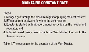

 Table 1 presents a simplified operation sequence.
Typically, vent header pressure is lower than return header pressure, which must be reversed for flow to occur from the vent header to the process return or disposal return header. An on-board eductor increases vent header pressure, inducing a vacuum, like a solid-state pump. This higher pressure at the outlet of the eductor overcomes the higher pressure in the return header; samples gases are pumped from the low pressure vent header to the higher pressure return header. In this process, the vent header maintains a constant pressure within ± 0.3 in. of water column (IWC). Constant pressure enables reliable and accurate analyzer measurements.
The pump, designed with an economizing circuit, controls the nitrogen motive force through the eductor depending on the return header pressure, which can be as high as 20 psig. When the return header pressure is lower than 20 psig, the economizer circuit is activated and reduces the flow rate so that nitrogen is not wasted. In conditions where return header pressure is higher than what the eductor can handle, a pump can be installed to draw sample from the vent header and dump it into the process or disposal return header. The unit also can be modified to work in conjunction with a plant’s existing vacuum system.
