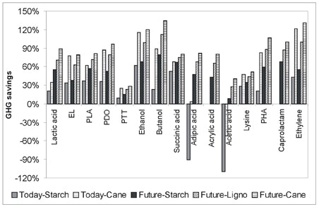

A second study focused on using a common methodology to assess the environmental impact — namely, greenhouse gas emissions and non-renewable-energy use — for the same 15 bulk chemicals over their entire life cycle. The results, recently published in Environmental Science & Technology, indicate that biofeedstocks provide significant savings compared to conventional petrochemical-based routes for most of the products — fermentation now doesn’t offer benefits only for adipic acid and acetic acid but eventually should (Figure 1). Indeed, Hermann adds that future fermentation technology may reduce greenhouse gas emissions by more than 100% when energy credits are considered.
Figure 1. Most bio-based routes provide reductions in greenhouse gas emissions. Source: Environmental Science & Technology.
