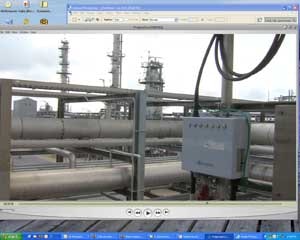

Huntsman and Apprion began implementing a plantwide network in May 2008 on 400+ acres of the Port Neches production area. To provide Huntsman with complete coverage for access to critical data anywhere and at anytime, more than 90 IONizers, Apprion's multi-radio, multi-protocol access points, were installed (Figure 1). The network was engineered with the future in mind — it was enabled with VoIP capabilities and scalable to support many other applications of wireless technologies going forward.
Access Point
Figure 1. More than 90 such points enable full and continuous access to critical data.
