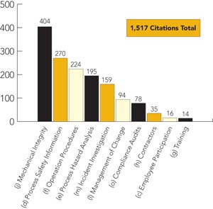

Refinery NEP Citations
Figure 1. Ten elements of the PSM Standard accounted for 98% of findings (through May 2009)

Through May 2009, OSHA has issued 1,517 citations resulting from the Refinery NEP. Approximately 98% of these related to ten elements of the standard (Figure 1). Approximately 75% of the citations were against specific sub-elements, (Table 2). The Refinery NEP citations represent approximately $4.7 million in initial fines. The Chemical NEP probably will focus on similar aspects of PSM programs, at least initially, until citation trends in the chemical sector are established and the dynamic question list is adjusted to account for those trends.
