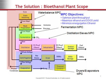

Ethanol Plant
Figure 1. Model predictive control enables optimization of the entire facility.
Because all processes — milling, fermentation, distillation, drying, etc. (Figure 1) — were integrated by energy or material flow, finding a way to optimize the process and maximize operating margin proved difficult. While existing proportional-integral-derivative (PID) controller strategies automated individual portions of the plant, these simplified controls didn't capture all interactions across the plant that could be optimized.
So, even with well-trained operators, accurate laboratory measurements and best-in-class PID controls, variations in key plant parameters were too high, resulting in inconsistent production. Cardinal Ethanol needed to capture, analyze and control all parts of the plant under a single, unified model.
The company turned to Pavilion8-based model predictive control (MPC) technology from Rockwell Automation to stabilize and drive peak efficiency across the entire plant. The system can be built and added as a supervisory control system without modifying existing process equipment. Moreover, this technology has proven itself in more than 30 ethanol plants, producing significant margin gains in each facility.
