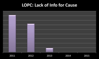

An Essential First Step
A pre-condition for Walk the Line is understanding the causes of operator line-up error. This becomes problematic if investigations stop at “operator left valve open” as the cause. As Celanese developed our Walk the Line program, it became clear that we first must improve the quality of our incident investigation process and root cause analysis (RCA). We approached this in two ways. After identifying the line-up error incidents, we asked each site to analyze its near-miss and incident data to the best of its ability to identify why the errors occurred. In addition to this analysis, we completed a global incident investigation management-training program that targeted improving the quality of the application of RCA methodology to give greater consideration to human factor causes. We instituted a practice of reviewing all Tier 1 and Tier 2 RCAs to normalize the quality of cause maps and corrective actions. The metric we chose to measure effectiveness of the training and RCA reviews is “lack of information for cause.” Figure 1 shows the improvement trend since these practices were initiated, with 2011 as the base comparison year.
Improvement Metric
Figure 1. The number of incidents without adequate root cause analysis has dropped dramatically.
As our RCAs improved, we were able to characterize the causes of line-up errors as: expectation for energy control not set, lack of continuity of operations, and deficiencies with operational readiness. Walk the Line was adopted as a readily recognizable way to raise awareness in these three areas.
