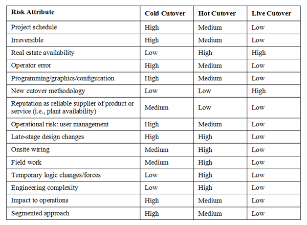

Potential Cutover Risks
Table 1. The live cutover approach provides an attractive new alternative.

A cold cutover also is known as a “rip and replace” project because the old equipment is removed and the new system is installed in its place during the outage. Cold cutovers also require a full plant outage to be able to cutover the common parts of the facility shared by all process units.
For this reason, many facilities use hot cutovers to migrate one signal or loop at a time by placing it in manual and then physically moving the associated wires from the old system to the new one. This obviously requires operating both systems in parallel, which demands sufficient real estate in the control room area to do this work.
Table 1 summarizes the likelihood of experiencing some of the risks associated with the different cutover strategies. As it shows, cold and hot cutovers pose different risks to production. One cold-cutover challenge not identified in the table is executing the project when everyone in the facility already is stressed to meet schedule; it also doesn’t cite the added personnel generally needed on site then and the required outage premiums being paid.
The third column covers a new migration/cutover technique [3]. This live cutover method allows for migrating control systems with minimal risk to production. It features a specialized temporary tool that enables wiring from one control system to another without disrupting the signals.
