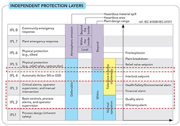

The Protection Hierarchy
Plants rely on a number of independent protection layers (IPLs) to handle incidents (Figure 1). If an event moves up the list of layers, each escalation results in a more drastic action and has the potential to cause a more catastrophic impact.
Independent Protection Layers
Figure 1. The consequences of a particular alarm condition determine the number of layers required.
Effective process alarms are part of IPL 2 and 3; they should spur actions to address an incident within those layers because that will avoid or at least minimize production disruptions. Moving to IPL 4 leads to a more drastic action related to the safety instrumented system (SIS) or an emergency shutdown (ESD) function, which almost invariably results in more severe consequences capable of adversely affecting production levels or quality.
Even so, the situations causing alarm trips at IPL 2 can undermine, even if only slightly, operational efficiency and product quality. Some plants tend to concentrate on protecting equipment and, thus, give the highest priority to those alarms. This often is wasteful because those equipment protection functions are better left to IPL 4. Giving those alarms the highest priority makes the entire alarm system more difficult to handle.
At the same time, moving to IPL 4 often brings a new wave of alarms that aren’t related to process conditions but to the performance of the SIS itself. For example, if the valve at the inlet of a reactor doesn’t close as it should when directed by the SIS during an incident, an alarm should trip to warn that this emergency step hasn’t happened and the valve may require manual closing. These types of alarms should be in their own category because the consequences of such situations are well beyond those of alarms tied to IPL 2 and 3. Some plants don’t set these alarms apart; they become lost among more trivial lower-level ones.
Consequences And Actions
Figure 2. Delay in responding to an alarm can lead to more severe impacts as an incident escalates through protection layers.
Therefore, it’s critical during the alarm rationalization process to determine the consequences of a situation generating an alarm and the corresponding remedial action (Figure 2). As the diagram illustrates, as a situation escalates, the consequences and needed actions become more drastic and have a more serious impact on production.
For existing processing facilities, it’s especially important to develop a plant-wide protection hierarchy and priority matrix to identify and create better alarm strategies. Alarm management and SIS evaluation both begin with inherently safer unit design. A unit that is well regulated will have fewer upsets, alarms and incidents. When alarms primarily serve as a mechanism to compensate for poor control strategy, the plant effectively is running in manual. Any evaluation of alarm strategy must begin by asking how well the unit runs under normal conditions and then correct any glaring flaws.
