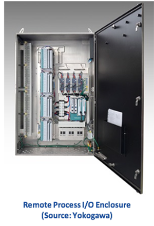

Remote I/O Enclosures
Process I/O equipment for early DCS products was located in unit control rooms or rack rooms with well-controlled environmental conditions (temperature, humidity, particulates, etc.). As more hardened I/O systems were developed, suppliers began to move I/O equipment into the field (closer to the field transmitters, valves, etc.). Remote I/O enclosures were networked to the physical controllers using high-speed redundant networks, typically dual fiber optic Ethernet that could support the long cable runs sometimes necessary.
This trend is already deeply established in the market. The business value comes through lower installed costs via reduced cabling requirements and complexity. Older designs required I/O signals to be first landed at field junction boxes and then wired to the control area using multi-conductor shielded cable. Both the material and labor cost of this traditional design are significant, as is the engineering complexity. The only opposition to the remote I/O enclosure trend is where environments are so extreme that even the most hardened electronic equipment cannot function reliably. Save for those environments, the use of remote I/O enclosures in distributed control systems is now a given.

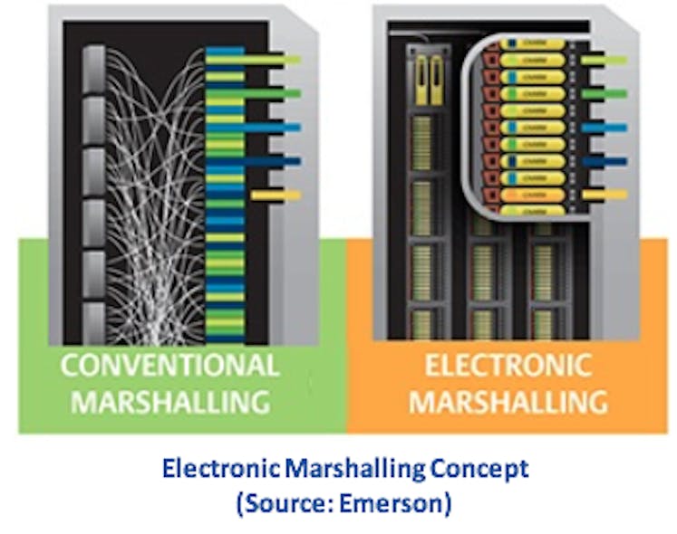

The trend toward electronic marshalling consists of replacing traditional process I/O modules with either “smart” I/O modules or single-point smart signal conditioners. Often, this new and more intelligent I/O equipment is located in remote field enclosures, significantly adding to their value. This trend makes field I/O equipment and enclosures much more standardized (and commoditized) than before. Projects can order fixed-size field I/O enclosures in bulk with no significant custom engineering. These can be installed, powered up, and wired earlier in a capital project.
The “smartness” of the I/O enables project teams to assign field device termination points in these enclosures much later in a project, when more detailed engineering information is available. The commoditized I/O enclosures can be installed pretty much independently of the state of detailed field device and DCS engineering information.
DCS suppliers have developed new field software tools that can interrogate these remote enclosures and test the field devices and field connections in bulk. Using these software tools, the as-built field configuration of the field enclosure is then integrated with the control and HMI configurations created for the project, but at a much later stage in the project. Referred to as “late binding,” this can help compress project schedules to a significant degree. Reduced project schedules can save millions of dollars per day in some cases. In many projects, savings from significant reductions in the project schedule via electronic marshalling are larger than the cost of the entire distributed control system, providing significant business value.
Given that major suppliers have adopted this trend, their standardized remote I/O enclosures with electronic marshalling become the dominant form factors for most hardware they deliver. Thus, the cost and quality of these I/O enclosures is becoming critical to their overall competitive position.

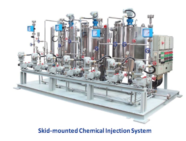

Rapid Integration Of Skid-Mounted Systems
Increasing amounts of process manufacturing equipment is delivered on a module or “skid” containing its own local control system. Also, projects are procuring growing numbers of such standalone skid-mounted systems because they can simplify procurement, reduce on-site construction costs, and simplify physical integration.
With more skid-mounted systems, it becomes increasingly problematic and time consuming to integrate this skid equipment into automation systems. Project teams have wrestled with this trend because integrating large numbers of field systems with DCS control and HMI functionality can be time consuming, risky, and likely occur at the end stage of a project. As a result, DCS suppliers have developed improved methods to integrate these systems quickly and accurately.
For example, automation suppliers have developed new DCS controllers designed specifically to be included in the skid-mounted system and easily integrated into a larger DCS. While an elegant solution, this is not always feasible from a business standpoint. Often skid system suppliers are unable or unwilling to use DCS equipment and technologies to implement their control functionality. Changing their control technology may force them to incur significant additional costs and risk. So, specialized DCS controllers designed for skid systems do not solve the entire skid integration problem by any means.
One important trend now emerging to integrate these systems is the growing use of OPC UA and related technologies to speed up and improve the accuracy of the integration. OPC UA is becoming an increasingly common technology for system interfaces. Its advantages are a high degree of software independence as well as important features such as the capability of the OPC UA interface to interrogate (“discover”) remote system resources.
Building further on OPC UA is the NAMUR MTP (module type package) technology. MTP technology describes multiple aspects of a skid system using XML in a vendor-neutral manner. This includes its control components, physical components, and operator interface. MTP technology is still being developed, but the work has received widespread support and seems to have significant momentum in the market. Early adopters of MTP are in the fine chemical and pharmaceutical vertical industries. But ARC believes that MTP will eventually become an important and a common method for rapid system integration in all manufacturing vertical industries that employ continuous or batch process manufacturing.
