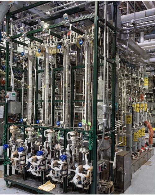

The pilot unit for the prototype project is a refinery-catalyst-testing process made up of four parallel reactor trains (Figure 1). This process is operated at about 1,200 psi and around 750°F with H2 and crude oil as raw materials with process flow rates measured in ml/h or g/h. While the pilot unit is small in scale, the presence of sensors for H2S and combustibles and an emergency shutdown capability provide proof this tiny plant is a very real process that can be operated safely by trained operations technicians. The process automation system interfaces with an existing safety instrumented system (SIS), gas chromatograph, and laboratory information system. The pilot-unit automation system uses about 130 input/output (I/O) points including AI, AO, DI, DO and J type thermocouples, and has 25 control loops and nearly 600 tag parameters recorded in the historian each second.
Prototype System
Figure 1. Pilot unit in New Jersey contained four reactor trains and had about 130 I/O points.
The pilot unit produces data in balance batches where the priority is to maintain tight control of the process conditions because disturbances and deviations cause the immediate invalidation of the test and require a restart of the test once process conditions stabilize. For the purposes of the prototype test, the process conditions would be repeated in consecutive batches and the process control performance, OPA-based automation system functionality, and balance data would be compared to batches run just prior to the migration from the legacy DCS system.
