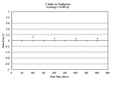

Viscosity is a very important fluid parameter because it directly influences the propensity of the fluid to hold up air (or gas). In a low-viscosity liquid such as water, air bubbles coalesce from finely distributed small bubbles into large ones that collect at high points in the line. In contrast, if the bubbles stay finely distributed, as happens in high-viscosity liquids, they will be purged from the meter easily and not collect — and metering will be accurate. Figure 2 shows results for toothpaste with a viscosity of 10,000 cP and entrained air level between 2 and 5%. Rates are quite low for a 2-in. meter (<0.6 m/s) yet performance is well within specification.
Figure 2
Even at low flow rate, measurements for 10,000-cP toothpaste with 2-5% void fraction are within specification.
