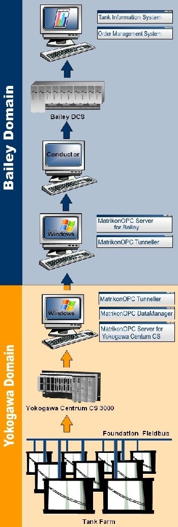

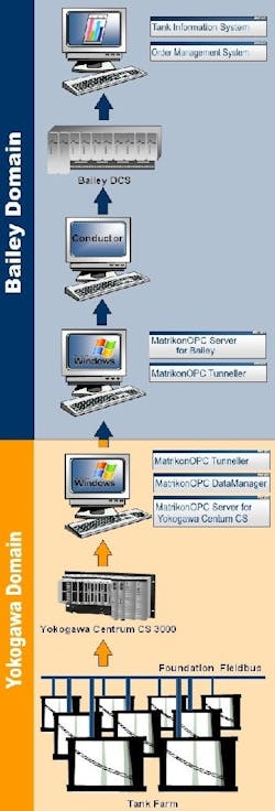

Integrating the new server meant tackling a difficult interface problem. Since the tank gauging hardware was interfaced with the Yokogawa but the visualization tools were connected to the Bailey system, they needed a way to transfer data from one control system to the other (Figure 1). Matrikon OPC’s Data Manager is an off-the-shelf solution that transfers data between control systems. But because the control systems were on different Windows domains, there were DCOM issues.
Figure 1. The robust solution provided true inter-operability that was easy to integrate with commercial off-the-shelf software.
To overcome the final issue, the refinery opted to use OPC Tunneling technology to handle the DCOM problems. OPC Tunneling is a secure and reliable way to transfer data between different domains. Once Matrikon OPC’s Tunneler was installed on the network of each domain, Matrikon OPC Data Manager could seamlessly transfer data between the two systems.
