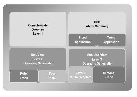

What were the results? While the two groups were of equivalent skill levels, and the simulated plant upsets they encountered were identical, the results were astoundingly different. The operators using the ASM-style interface out-performed their counterparts. The results make a strong case for improving the effectiveness of an often-neglected element in a chemical plant: the interaction between humans and control systems. Figures 1 and 2 compare the views available with different interfaces.
Figure 1 Operator forced to hunts for information
Figure 2: Managed process information – available to operator

Elements of the ASM interface
The ASM-style displays used in the study are extensions of an earlier ASM display prototype called Abnormal Event and Guidance Information System (AEGIS). AEGIS was designed for scenario-based task analysis and was intended to improve the console operator’s situational awareness to changing plant conditions. The displays implemented in the study took it even further by integrating trends and provided access to additional online information, among other enhancements.
ASM interfaces are designed for proactive monitoring, which requires a big-picture awareness of the plant. Key features include integrated trends of information, multiple levels of increasing plant detail, and easy display navigation that is integrated with the process alarm management. This allows operators to see a broad picture of the process, but also gives rapid access to detailed information when necessary, in the context of the entire process.
Some of the key ASM features include:
  • multi-windowing with controlled window management to minimize display overlays;
  • multi-level, simultaneous views of increasing plant detail;
  • yoked navigation between display levels (i.e., automated display invocation through pre-configured display associations for assisted, task-relevant navigation);
  • tabbed navigation within a display level;
  • integrated trending of historical information;
  • integrated alarm management into graphics and navigation tabs
  • right-mouse click access to online documentation;
  • human factors graphics design (e.g., principled limited, color-coding of critical, changing information;  limited 3-D objects; simple, effective symbols); and
  • access to online information (e.g., alarm rationalization documentation, operating procedures, shift logbook, etc.)
The ASM-style interface presents process data in a way that better matches human cognitive abilities, making the data more valuable. For example, trends are continuously displayed to show critical-variable status over time, something that people are not good at estimating from memory based on snapshots of digital readouts. Color is selectively used to highlight dynamic information such as alarms and conditions that require an operator’s attention. Also, different levels of detail – or a display hierarchy – are simultaneously shown, which better matches the way people think about information when they are troubleshooting.
