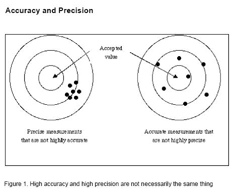

The limiting factor for minimizing inherent sensor error is the uncertainty (including both the accuracy and precision) of the calibration process. Generally, thermistors and RTDs have better inherent accuracy than thermocouples, but all three types of sensors will require calibration to achieve accuracies down to 0.1˚C. It is more challenging to calibrate thermocouples than thermistors and RTDs — calibration must consider both hot and cold junction temperature errors.
