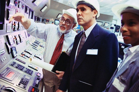

Figure 1.  Typical stressful day in a control room
