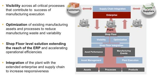

If you face any of these issues, you should take a look at integrating product and operational management into your environment. With such integration, you have visibility into all aspects of your manufacturing operations (Figure 1).
Figure 1. Effective plant-to-business integration enables faster response and better use of assets.
This provides the ability to respond faster and minimize impact to the business and bottom line, driving increased yields, asset utilization and order fulfillment — in other words, you’ve got the "perfect plant."
