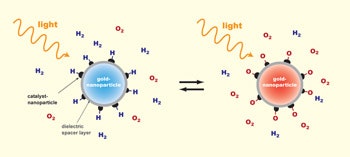

The sensors consist of arrays of nanofabricated gold disks with a thin (about 10 nm.) coating on to which catalysts nanoparticles are deposited. In principle, they can work with any nanocatalyst because the underlying phenomenon — a change in the composition of the chemsorption or thin surface layer altering the polarizability/dielectric properties of that layer sensed by the LSPR (Figure 1) — occurs with all catalytic materials, the researchers note. Changes in surface coverage of less than 0.1 atomic monolayer were easily detected under high pressure, sensitivity unrivalled by commercial instruments under those conditions, says Elin Larsson, who now works at the Competence Center for Catalysis at Chalmers.  Sensitivities, of course, will vary with particular system. There're no limitations in what can serve as support material; alumina, titania, zirconia, iron oxides and various carbides will work as well as the SiO2 used in their tests, the researchers add. Sensing structures used so far haven't been optimized as to shape, size, material of the LSPR sensing particles or separating layer.

Figure 1. Light excites plasmon resonance in nanoparticle; color change indicates different molecule has been absorbed. Source: Chalmers University of Technology.
