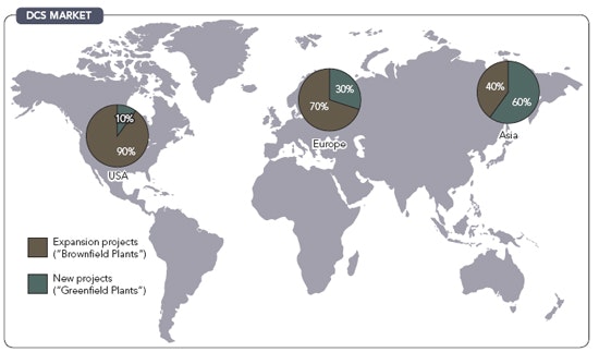

DCS Market
Figure 1. Brownfield projects will predominate in developed countries. Source: ARC.
