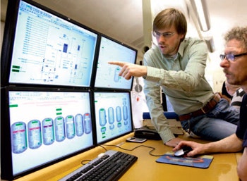

Figure 1. Integrating the safety instrumented system with the process automation system may offer significant advantages.

Integrated, interfaced or separated? A safety system integrated with the process automation system offers many key benefits, drawing on common capabilities of the process automation system not related directly to the safety functions (Figure 1). However, in some cases, it may make more sense to only interface the two systems or to keep them completely separate. Use the SRS and your business requirements to determine which option is most appropriate.
