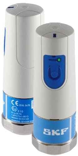

Wireless Sensor
Figure 1. This compact battery-powered device measures vibration and temperature, and contains a sensor, data collector and radio.

The recent development of a compact, battery-operated device (Figure 1) to measure vibration and temperature data exemplifies how far the technology has advanced. System components consist of the wireless machine-condition sensors, WirelessHART communications protocol gateway, wireless sensor device manager software and analysis software. The technology wirelessly transmits data to monitoring suite software and plant control systems; it is suitable for use in extremely hazardous and explosive areas requiring ATEX Zone 0 certification.
Such a device can augment readings taken by workers during walk-arounds by collecting data automatically and more frequently from plant areas where manual data retrieval might be uneconomic, impractical or unsafe. Temporary installation of the sensor on suspect equipment can enhance troubleshooting by enabling much closer tracking of failing components; the device also allows acquisition of vibration data in locations difficult to monitor with wired systems or handheld devices.
