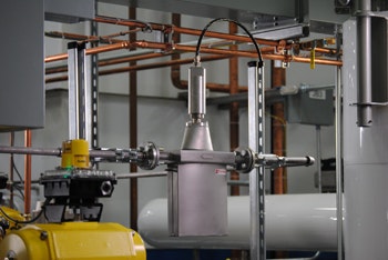

Coriolis. These meters contain a vibrating tube in which a fluid flow causes changes in frequency, phase shift or amplitude. Circuitry in the devices then converts this signal into an output that’s strictly proportional to the actual mass flow rate — in contrast to thermal mass flow meters, which depend upon the physical properties of the fluid.
[javascriptSnippet ]
One of the most important features of a Coriolis flow meter (Figure 1) is its ability to directly measure fluid mass with a very high degree of accuracy over a wide range of temperatures. Its unobstructed open-flow design is suitable for viscous non-conductive fluids that are difficult to measure with other technologies. With no internal moving parts, a Coriolis meter requires a minimum amount of attention once installed. However, such devices sometimes are considered too sophisticated, expensive or unwieldy for certain applications.
Coriolis Meter
Figure 1. Such meters can directly measure mass flow with very high accuracy over a wide range of temperatures.

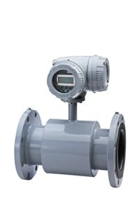

Electromagnetic. Such meters employ Faraday’s law of electromagnetic induction, whereby voltage is induced when a conductor moves through a magnetic field. The liquid acts as the conductor, with energized coils outside the flow tube creating the magnetic field. The produced voltage is directly proportional to the flow rate.
An electromagnetic meter (Figure 2) will measure virtually any conductive fluid or slurry, including process water and wastewater. The devices provide low pressure drop, high accuracy, large turndown ratio and excellent repeatability. The meters have no moving parts or flow obstructions, and are relatively unaffected by viscosity, temperature and pressure when correctly specified. Electromagnetic meters tend to be heavy in larger sizes and may be prohibitively expensive for some purposes.

Electromagnetic Meter
Figure 2. These devices can monitor virtually any conductive fluid or slurry found at a plant.
