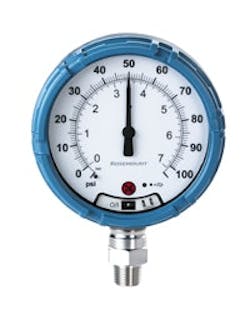

Wireless Digital Gauge
Figure 2. Such instruments not only transmit pressure data but also device health information.

A wireless pressure instrument (Figure 2) addresses many issues that undermine the performance and life of a Bourdon tube gauge. Table 1 summarizes five key challenges and how wireless gauges handle them.

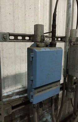

Data are transmitted from each wireless instrument node, such as a pressure gauge, via the mesh network to a wireless gateway (Figure 3). WirelessHART uses the mesh network to provide redundant paths of communication as each node can receive and retransmit wireless information.
From the gateway, the information gathered from wireless pressure gauges and other wireless instruments goes to the plant’s control, asset management and other systems via hardwired links using industry standard protocols such as Modbus, OPC or HART IP across electrical connections such as RS-485 or Ethernet. Data are accessible to these systems within minutes.

However, if no WirelessHART network exists, the plant must put one in. The hardware costs for the network are minimal because the only requirement is to install and provide power to a WirelessHART gateway. A 100-node gateway costs about $6,000, with 25-node models available for less. Once in place, the gateway must be configured to communicate with the wireless instruments and then hardwired to the host system. This requires design time of roughly eight hours to configure the gateway to communicate with the wireless instrument and the host system.
Gateway
Figure 3. A single WirelessHART gateway can collect information from many wireless instruments.
