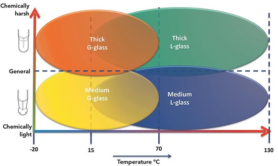

Applicability Of Common pH-Sensitive Glass
Figure 1. Thickness of the glass as well as its composition determine service range.

The suitability of an electrode depends on its type of glass membrane. Every manufacturer has its own unique formulation; however, some common types of glass are available:

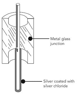

Normal Reference System
Figure 2. This relies on a silver wire coated with silver chlorine.
• “G” or general-purpose glass is used in processes where the nominal pH value varies around pH 7 and the operating temperature is from -20° to 70°C.
• “L” or chemical-resistant glass is designed for measurements in alkaline media with process temperatures up to 130°C.
• “Na” or sodium glass is utilized where good interaction with alkaline (sodium, potassium, calcium and magnesium) ions, rather than H+, is necessary. This glass serves as the reference element in differential sensors or as the measurement sensor for applications that determine/monitor salt concentration.
Figure 1 illustrates the general applicability of G and L glasses. As it shows, the range of any particular glass type also depends on membrane thickness.
Process conditions greatly influence the chemical resistance of the glass membrane. Elevated temperatures and high salt concentrations (NaCO3 and CaCO3 dissolve the glass) or applications in strongly alkaline liquids generally shorten electrode life. Additives can be included during the manufacturing of the glass to make it more resistant to attack; electrodes suitable for measurements in either strongly acidic or basic liquids can be produced. In aggressive solutions, a heavy duty electrode with a thick dome-shaped glass membrane is preferable.

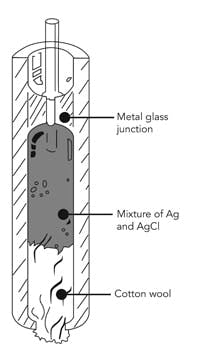

High Temperature Reference System
Figure 3. Such a system uses of a paste containing silver, silver chloride and potassium chloride.
Reference electrodes use a variety of reference systems, flow diaphragms and electrolytes.
Generally, reference electrodes rely on a silver/silver chloride-potassium chloride (Ag/AgCl-KCl) system. The reference system consists of a silver wire electrolytically coated with silver chloride (Figure 2). This metal-metal salt combination is dipped in a KCl solution.
An alternative construction more suitable for high-temperature applications dips the silver wire into a paste of Ag, AgCl and KCl (Figure 3). A plug of wadding soaked in KCl seals the paste into a tube. This reference assembly similarly is dipped in a KCl solution.

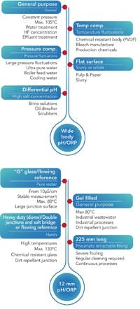

Selection Guide
Figure 7. These charts highlight factors that suggest a particular type of sensor for a given application.
Choose Correctly
Careful consideration of the demands of the specific application underpin achieving an accurate, reliable measurement with a sensor that provides reasonable life expectancy while minimizing required routine maintenance. If you’re frequently calibrating or replacing a pH sensor, then there’s a good chance it’s not the right combination for the process. Many general-purpose wide body (all-in-one) electrodes will work very well for many applications. However, some services do better if you choose individual electrodes with unique glass design and reference systems not available in an all-in-one design. Use the quick reference charts in Figure 7 as a best practice guide to find the recommended sensor based on the specifics of a particular application.
