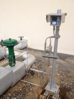

Figure 1. Loop-powered analyzer and conductivity sensor enable efficient removal of water from tank with minimal loss of naphtha.
This is a very tedious task for the operator because tank draining is a lengthy process (taking approximately 2–3 hours) that requires the operator’s presence during the entire operation. Also, visually determining the point at which oil, not water, begins to drain is not easy. Hence, there is a danger the drain valve will be closed too late, resulting in hydrocarbons flowing into the sump. This increases the load on the downstream water-treatment facility and, thus, water treatment costs and also wastes costly hydrocarbon raw material.
Conductivity is ideal for monitoring the drain. The water has a conductivity between 650 and 1,000 μS/cm while the naphtha has essentially no conductivity. As the water drains the conductivity is high, but when the naphtha interface is reached the conductivity falls. Thus, using an interlock system to close the valve at the first sign of a conductivity drop can ensure that draining incurs a minimum loss of naphtha.
In May 2016, Hanwha Total installed a Rosemount 1066 loop-powered liquid analyzer and 402 conductivity sensor (Figure 1) in 12 tanks. If the conductivity level passes a set threshold, the sensor alerts an operator in the control room and the system automatically closes the drain valve. The simple addition of the analyzer and sensors has substantially reduced time demands on the plant’s staff and, even more significantly, has dramatically decreased leakage of costly naphtha from the tanks.
